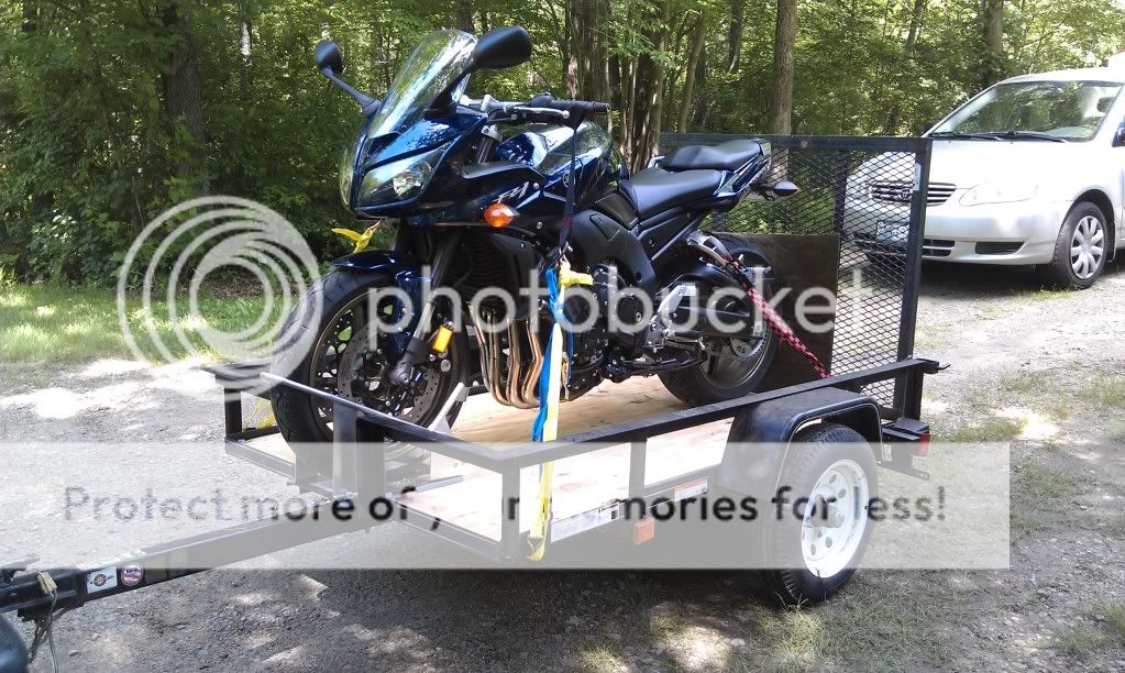

I picked up an 09 fz1 a couple weeks ago and was going to haul it in my trailer this weekend so I picked up a canyon dancer bar harness, last night when I went to strap it, it seemed to bend the bars down a bit with very little tension on the ratchet straps. I was tie-ing down almost straight/perpendicular to the bike,....is this normal. Please share your thoughts, thanks
The premise behind the Dancer is that the more it gets pulled "sideways", the more "steady" it is. Once you have it "taught", thats all you need. I also like to have the tie-down points "forward" of the bike, not directly in line with the handlebars. This way it keeps the bike going "forward". Its hard to see in this shot but I don't "cinch down" hard on them at all.
Just keep them slightly tight and you'll be fine. Do you use a wheel chock as well?

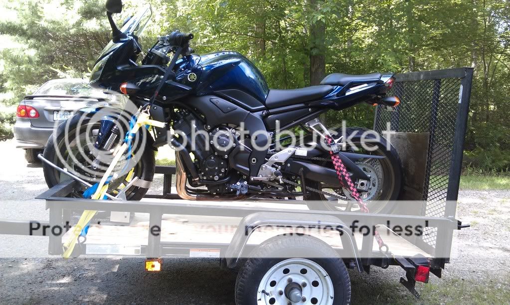

THAnks for the suggestions, moved the tiedown point a little forwards and had excellent results.
Looking at your photos of your latest tie down -You could move the tie down anchor spot up to the rail around the trailer and get even firmer lateral support with less stress in the ties. The tie down angle would be greater - which will give you greater side to side support (lateral).
You'll have to check that rail to see that it is securely fastened to the base of the trailer. Welds at the upright supports of the rail would be what you should have for best support - but the metal of the rail and supports looks from the pictures to be pretty substantial.
I'm glad it's working better for you. It looks like a nice trailer for the job.
