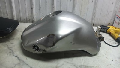

I did a quick search, this one is silver, one big ding from a drop:

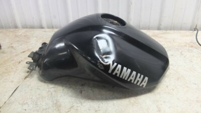

Black one, also a big ding in it:
Depending on how pristine you want your bike to look you can sand and prep these and find a color matched rattle can to paint the replacement tank. Or find a local body show to do it for you.
