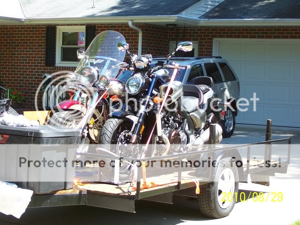

Edit: I found some shots with the Baxley Sport Chock holding the bike as well as it holding the Ninja 250 in the truck, so you can see it. Hope they came out okay.

I totally agree that Baxley is the clear cut choice, but not for the budget-minded and since Brad said "best bang for the buck" I gave him a known-working best-bang solution. ;) If I could afford it, it would be the whole darned Baxley two-place trailer FTW! :tup: I'd LOVE to have that beast!

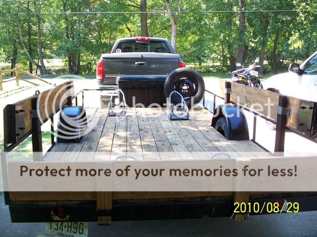

Same as Earlzach and here is a shot after they were mounted. I will admit that the finish on them isn't the best but that can be remedied with some powder coating. At some point about 3 - 5 years away, I see myself buying the Baxley trailer and being done with it! :D

Oh I agree. The reason I suggested the Baxley is you don't need to bolt it down at all. Also I really like the way the chock supports the bike.
Man those Baxley ones are awesome! I might have to wait until next years bonus for one that nice though! Like that trailer too!
