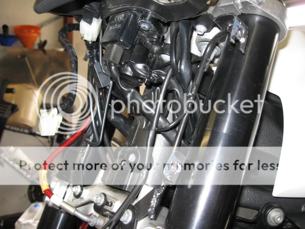

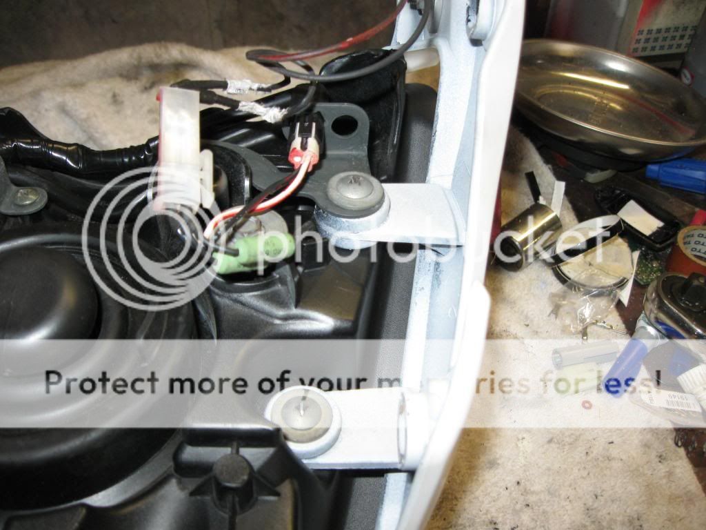

Some photos to help
1st shot is the wire and plate bracket mounted to triples
2nd shows the side plates (white) have grommets which slide over the posts on the back of the headlight into which the self tappers screw
Hope this helps.
