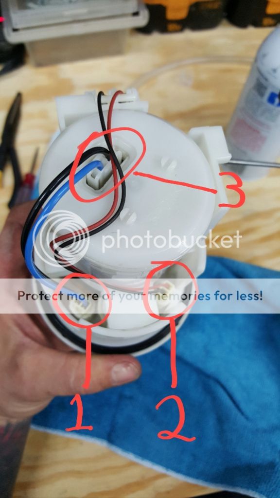

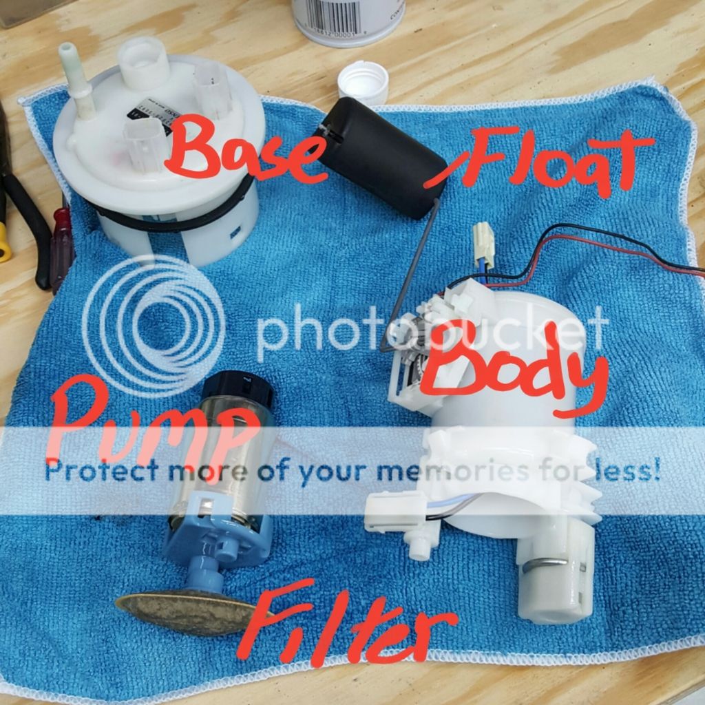

OK now getting to the fuel pump/filter assembly. With tank vertice (leaned up a wall with a towel to prevent damage tor paint) pull rubber pressure relief hose out of the way, remove the allenhead bolts from the aluminum retaining ring. Now carefully pull fuel pump assembly out of tank. There is a float for the fuel gauge attached so it won't come straight out, but turning it the right way it comes out very easily. Once assembly is removed, disconect #1 and #2 connectors carefully. Also be sure to keep plugs in same spots while reconnecting because they will fit in either spot. (Pictured ) I used small flat screwdriver just enough to depress locking tab and release connector. Now you can separate what I call the base from the body by pulling back the outer white plastic clips. Then disconect pump from body by releasing blue plastic clips. Slide pump out then remove plug from top of pump. Now you have access to fuel filter. Mine had small pieces of metal, dirt and other foreign material covering the bottom. I swirled filter in bowl of seafoam, poured some in top of pump and used a piece of clear hose and rubber stopper to blow down through pump. Wiped off filter with clean rag, reassembled same as it came apart.
