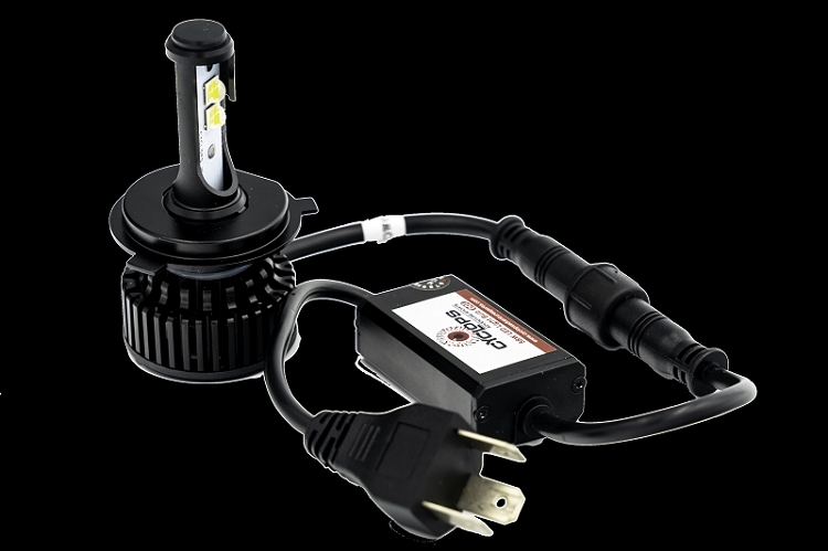

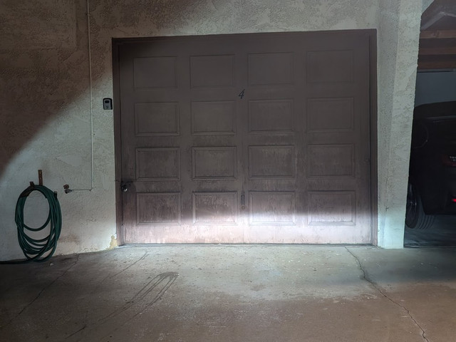

Back to the LED discussion I tried yet another set of cheapo Amazon H4 bulbs and they're insanely bright. There's a nice clean cutoff that matches the halogen cutoff but unfortunately there's a ton of scattering above the cutoff, so back to the halogen for now.
This was just the right bulb. You can see the clear cutoff with a lot of good usable light below the line. But above that line you can still see a big projection of the outer headlight lens, which isn't there with the halogen bulb. If I stand anywhere within that space it's blindingly bright.

I bought led off amazon, they were the ones that had positive reviews on youtube(I can look if you need). They are OUTSTANDING at night on high. Good on low. During the day I have had several people ask me what they were were for their bikes.
The cheap LED don't cast the correct patterns. Don't believe the lumen hype. It's about casting the right pattern
Please share, PM if you're not comfortable posting the link/brand.
You're 100% right, lumens are virtually irrelevant, it's WHERE those lumens go that matter. I'm on my third set to test and so far they're the same, excellent output but too much light where it shouldn't be.
That is exactly what I am talking about. Too many people would put those in and say the look fine to me and call it a job done and then go out and blind people. I am glad you checked that scatter to see how bad it was.
