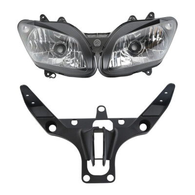

So can a 2002 r1 headlight fit too a 2002 FZ1. I can only find damaged headlights on ebay for FZ1 but the r1 has hundreds for sale even come with a bracket that appears might too attach too fz1 side view mirrors mounts.
They are different. The R1 extends the clear plastic face further around the outside edges. I don't know for sure if the plastic can't be trimmed, or it won't fit as is, but they are different. Agree that it would give Gen 1 owners many more options. How many of your tabs are broken? The metal support stay usually gets bent as well.
I started to repair a headlight using aluminum strips as the tab and 3M double sided structural tape called VHB (very high bond). I'm pretty sure it would work especially if you have other tabs that are still intact. Let me know if you want a pic of how I was proceeding.
Honestly my bike is stripped naked, I found a lot of jb weld holding most of the exterior together. so as long as it will bolt too the frame/front end that works for me.
My headlights are toast no save at all. they took most impact due to all the body being removed. photos is pre impact, so don't stop helping me out cause my bike is so ugly lol and plz excuse my finger.

And yes the lower arm of the metal support is bent but if i can make that R1 head light bracket fit too FZ1 it is not needed and will be gotten rid of at bend point.
Hadn't seen those R1 units before. You'll have to get lucky that the headlight is pointed in the right direction. Hopefully the two holes that attach to the boss on the Gen 1 headstock are the same distance apart , but you could drill new hole(s) and probably get the light pointed correctly. Hell of a lot cheaper than OEM parts.
OK got a R1 headlight on my FZ1, Had to cut out a small portion on the bracket and install with 2 large washers on bottom bolt.
