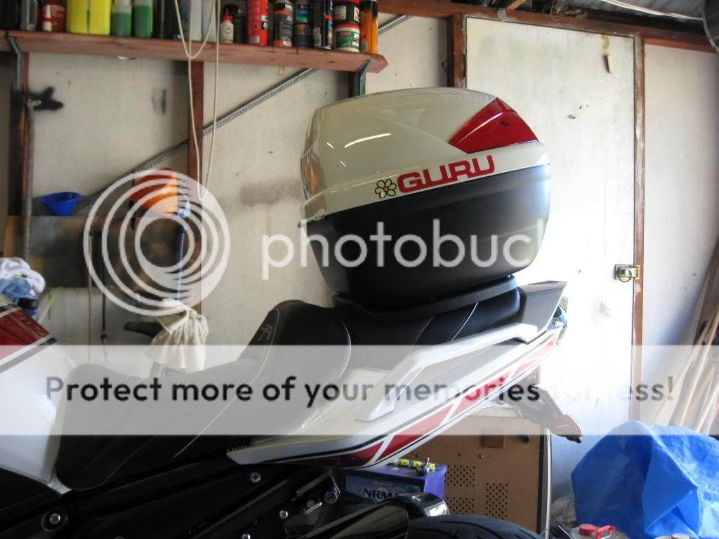

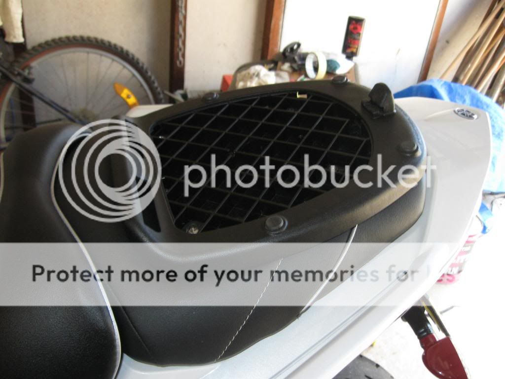

Plate Mounted. Dismantled the seat, cut two pieces of 22mm Alloy round Bar 50mm long. Drilled and tapped 6mm both ends for the rear mounts front mounts directly to pan. Cut foam to suite posts, reassembled and mounted up.
how about some plasti-dip or wrap the upper part till you get that sprayed.
Got to think that it's a language/cultural thing I think. "Guru" might be a big brand name thing in Italy? So they think everyone knows. Just pays to research. Pretty happy with the look now esp with a bit of extra detail in the pinstrpsOh that sucks the big one! But at least it looks great now!
