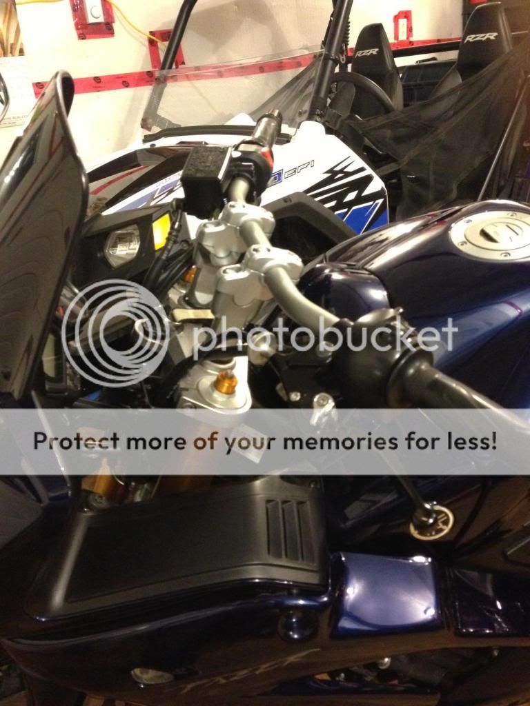

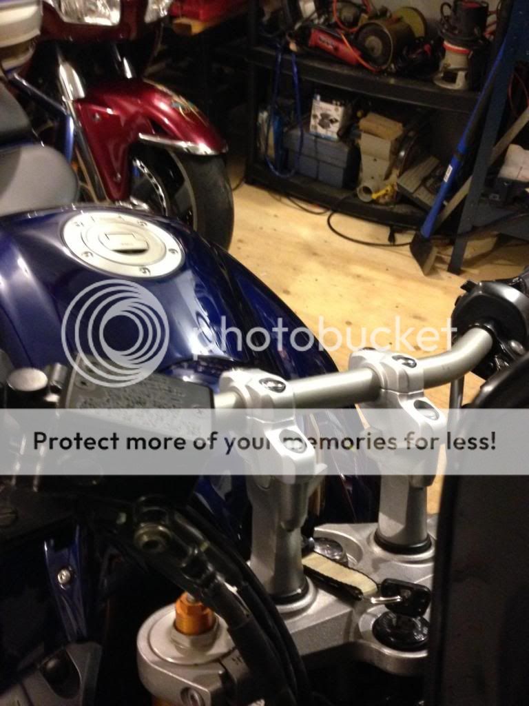

Risers "New with Pic's of installed product"
Looking at a set of risers with 1" rise 1.25" back.will the stock cables reach.? Did anybody try?
The clutch cable may be at the limit, but the brake line should be OK if you have stock brakes. If you have the R1 MC you will be short.
Also, if you stick with the stock bar width you will be OK, but if you go wider you will need to be careful. I had to cut 1/2" off each end of my Rizoma bars to get it all to fit.

Ok narrowed down to 3.still worried about all the lines,don't want to change any out.opinions please....
1" up 1.25" back
A quick Review:
standing back from the bike you can't notice the slight color variation at all.
took a quick ride up the road between the rain drops and it feels very comfortable,I'm 5'6 so it puts me more in a relaxed position as apposed to streatching out.
