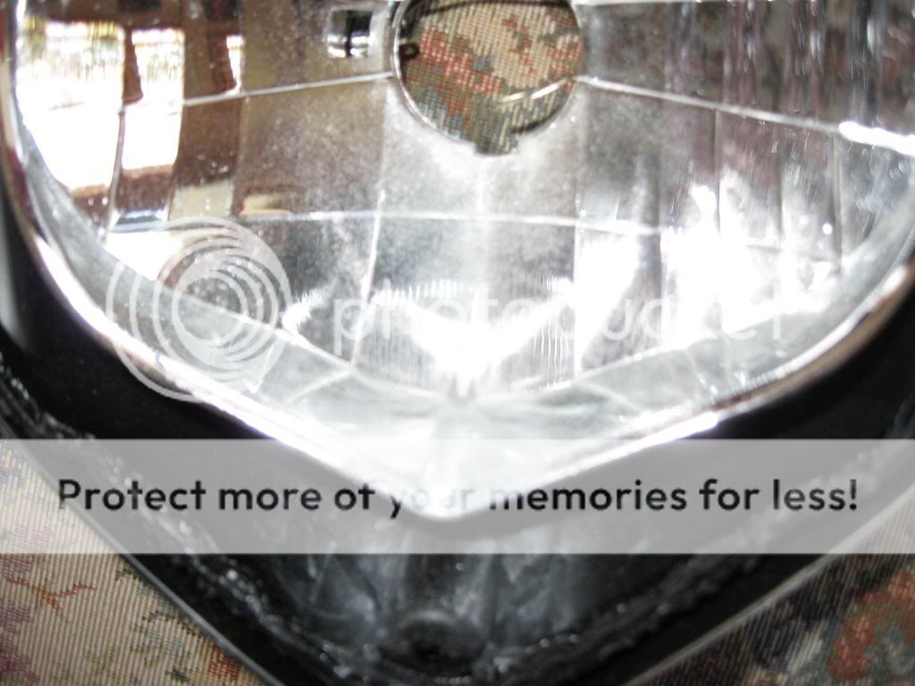

The Reflector needing cleaning

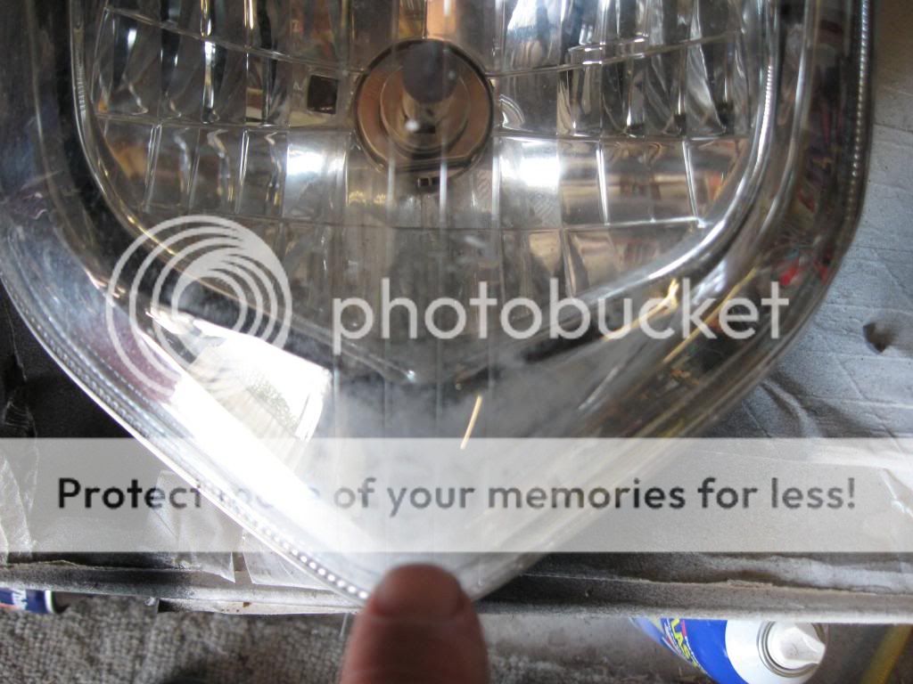

The inside of the glass "smokey"

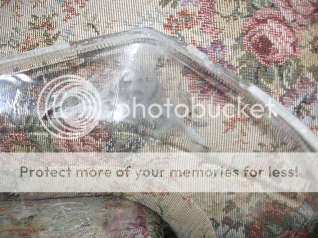

The lower part of the lens showing the cracking

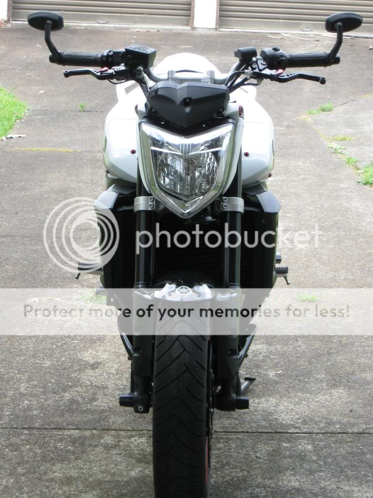

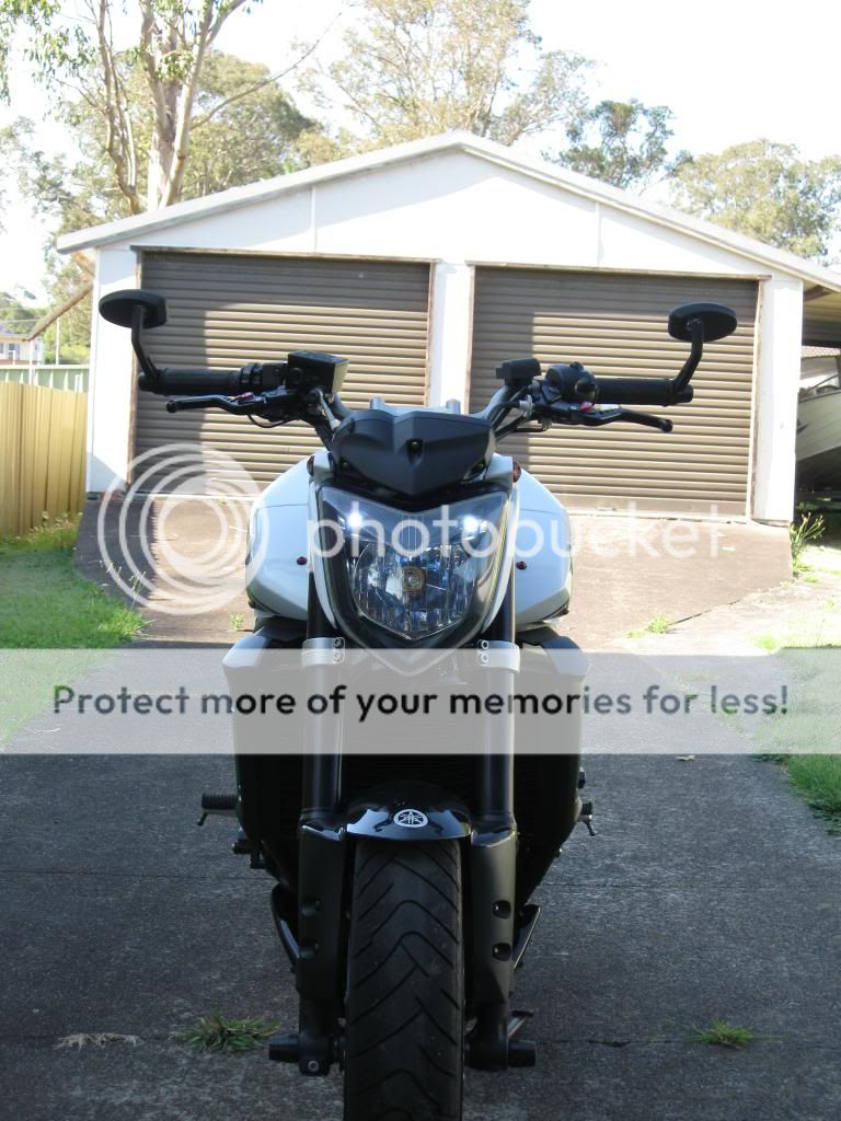

Before shot

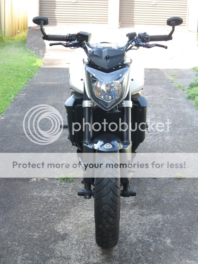

After
With 3w Leds in Park/brow lights
