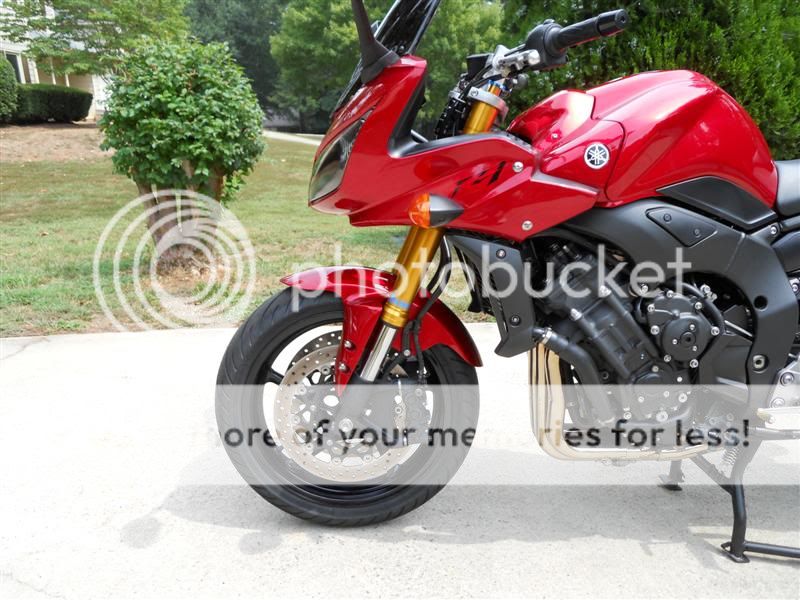

My brother installed a set of 07 R1 forks on his 06 FZ1, and he installed 07 6 piston radial calipers as well. Requires a 5mm spacer since the FZ1 disks are larger than the R1 disks. You can get he spacer from Honda - its used on a 07 up cbr1000.
I'm getting ready to do the same thing but with my 08 FZ1. Using forks and 6 piston calipers from an 08 R1 (from an R1 purchased to race). I got the spacers yesterday. Hope to have a chance to do the swap Thanksgiving holiday. I'm changing to steel brake lines and a R6 MC as well.

Better still, buy a set of 07/08 R1 rotors, they are fairly cheap on EBay and there is no mucking around with spacers. (That's what I did)

Yes . . .I don't get the idea of buying all the R1 parts, going to the trouble of installing them, yet keeping the stock FZ rotors which are heavier and force the use of spacers to allow the calipers to fit. People unload stock R1 rotors frequently on Ebay as they upgrade to aftermarket so they can be often had for cheap. The low mileage set I purchased was less than $40 shipped. You could also buy aftermarket bling rotors for the R1.
DO IT RIGHT DAMMIT! :)
Oh, and absolutely upgrade the stock FZ master cylinder to a radial design one like the stock R1 / R6 one.
Ir you're using 07/08 R1 forks (or Ohlins forks for 07/08 R1), you're definately going to want the "narrow path" rotor used with the 6 piston calipers. Using an older R1 rotor or FZ1 rotor & spacers just doesn't look right with the 6 piston caliper
The R1 pads only contact a portion of the larger diameter FZ rotors surface. How is this going to improve braking? Greater mass for heat dissipation? The R1 rotors are engineered to work properly with the R1 calipers, so I don't think that heat loading is an issue. Aftermarket rotors have even less mass.
