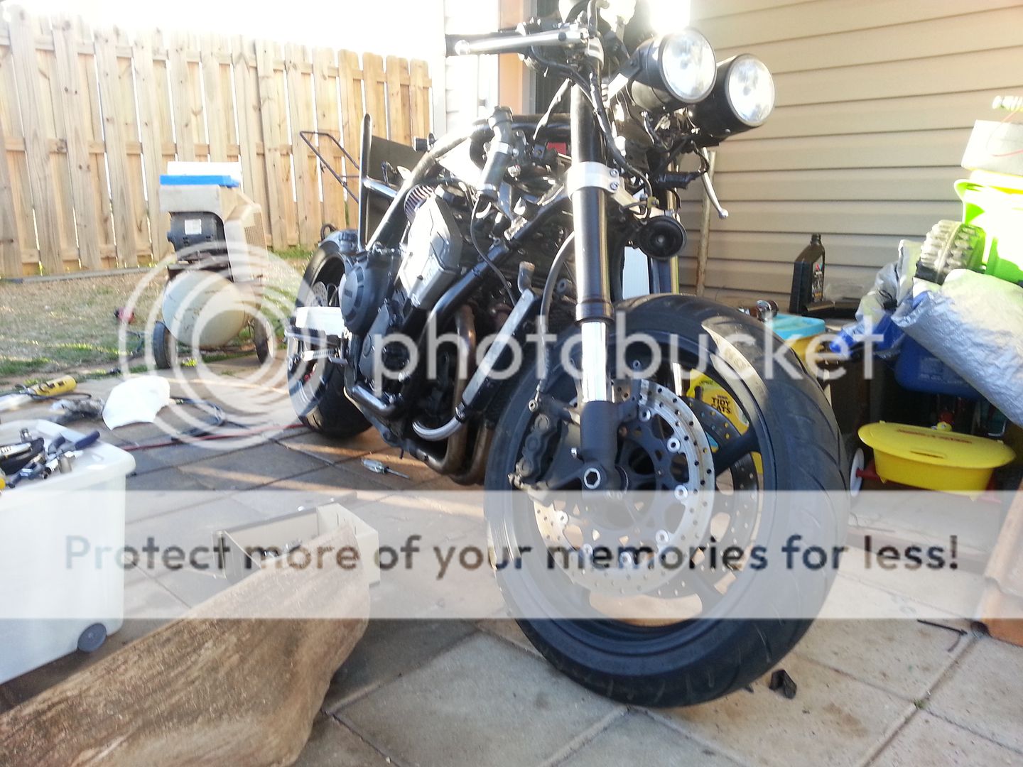

Big updates here and be warned this bike isn't for everyone and honestly no one but me

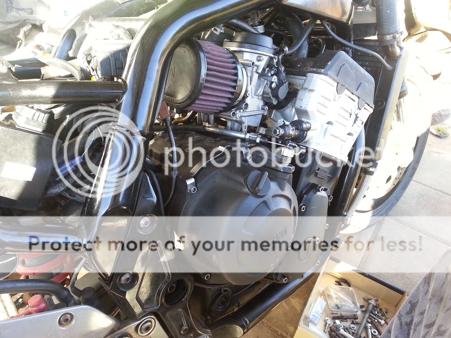

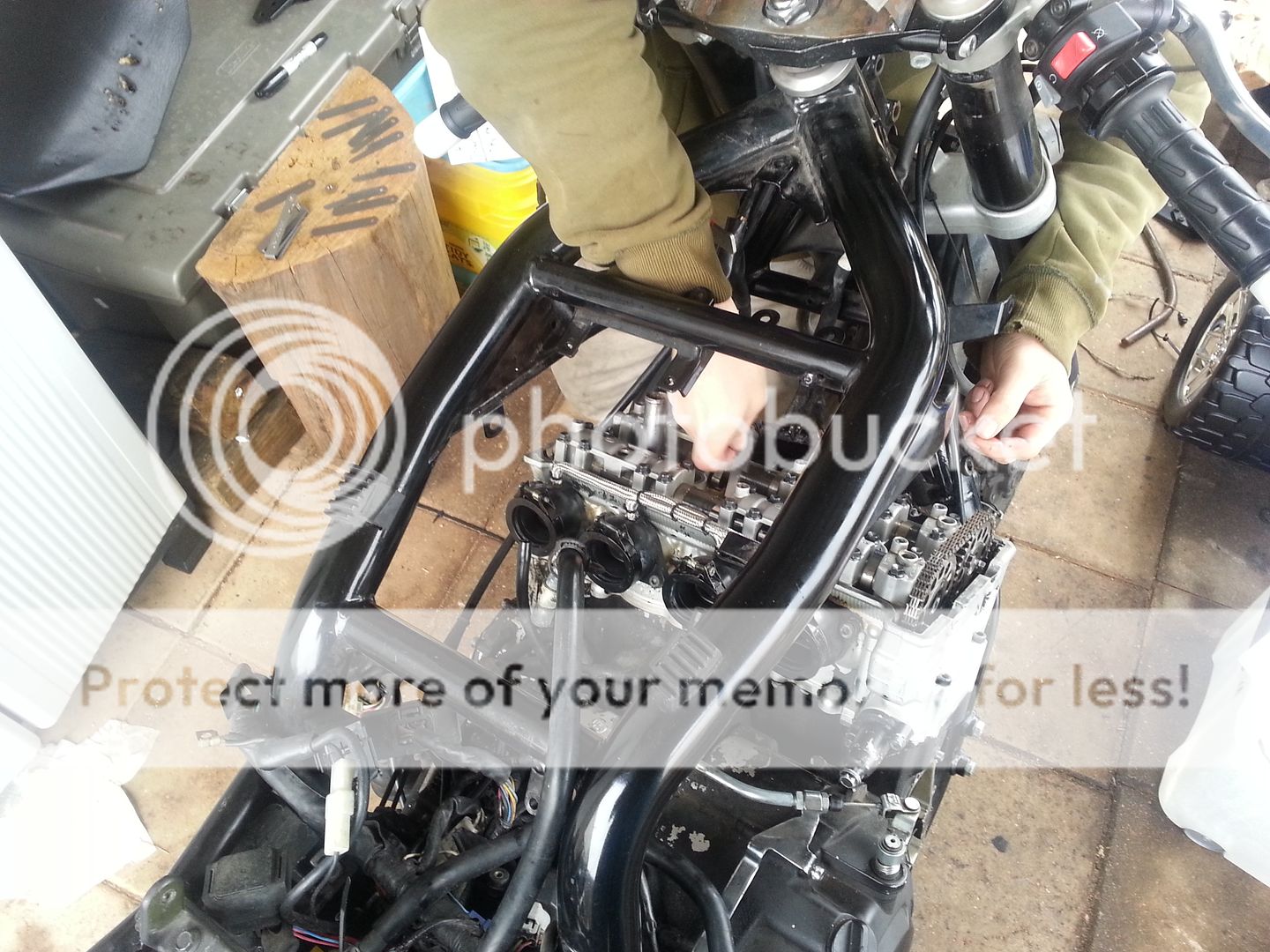

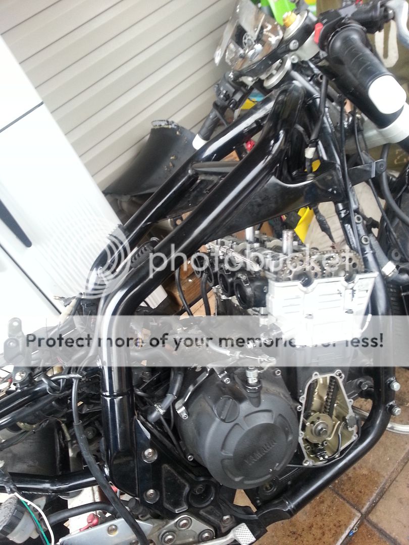

Rassembled the head after getting it tanked and decked.
Set Valve clearences
Fixed coolant hoses
Fixed bunch of wiring issues

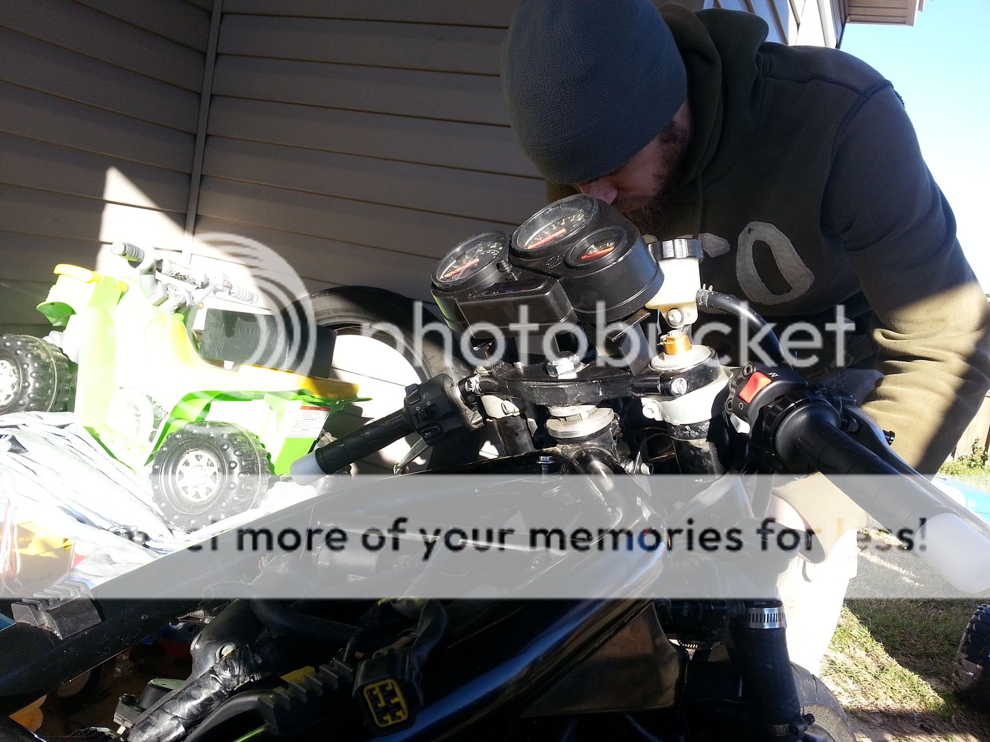

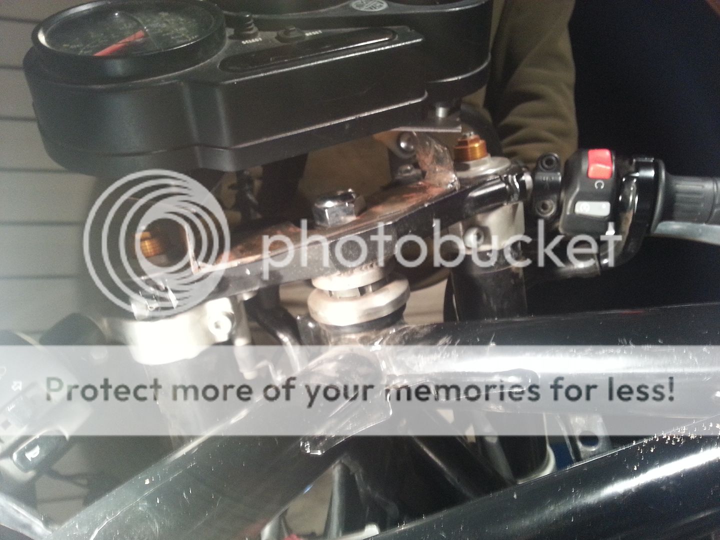

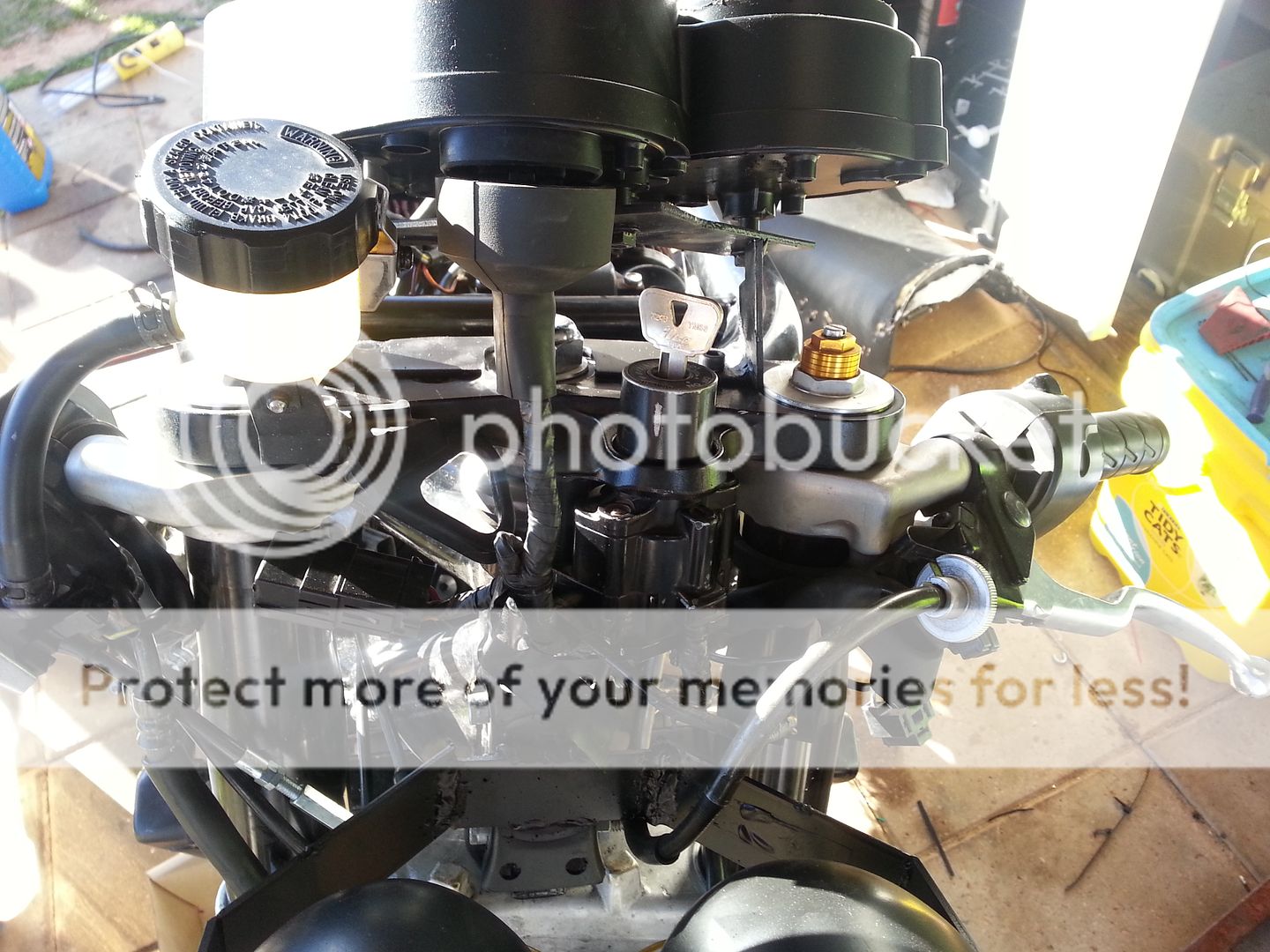

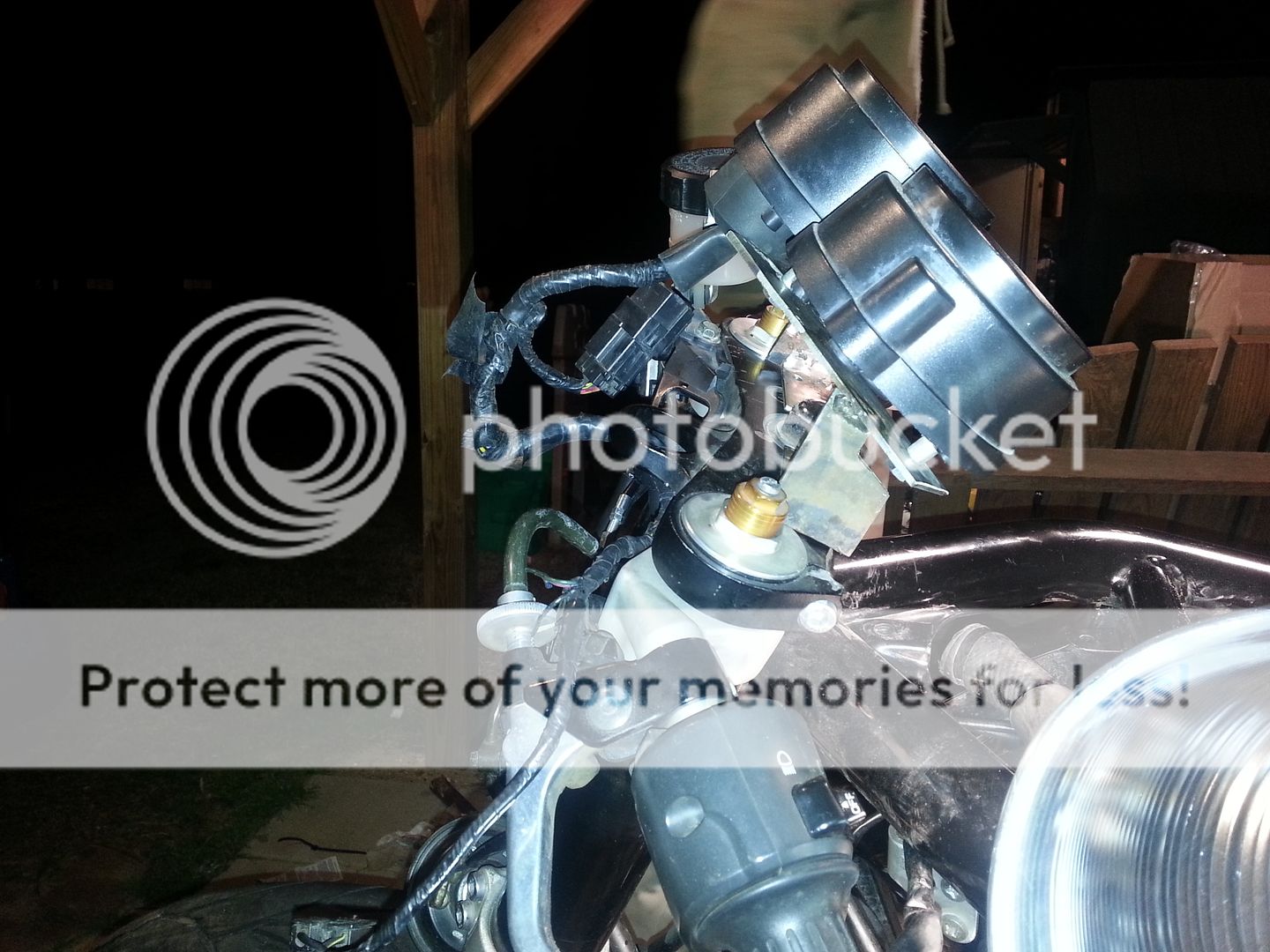

Made Cluster Bracket

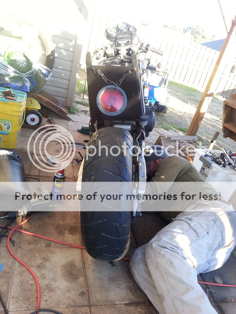

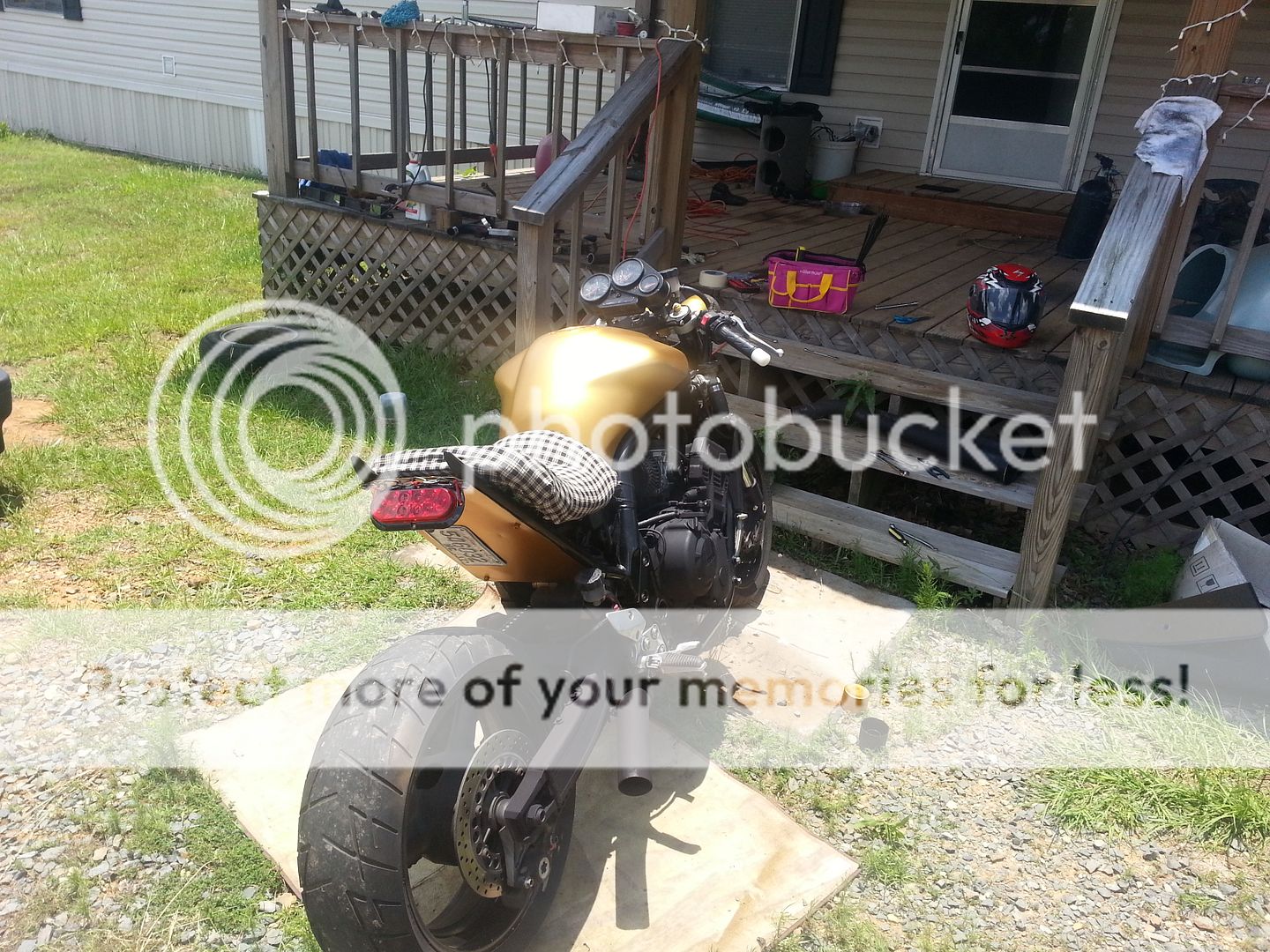

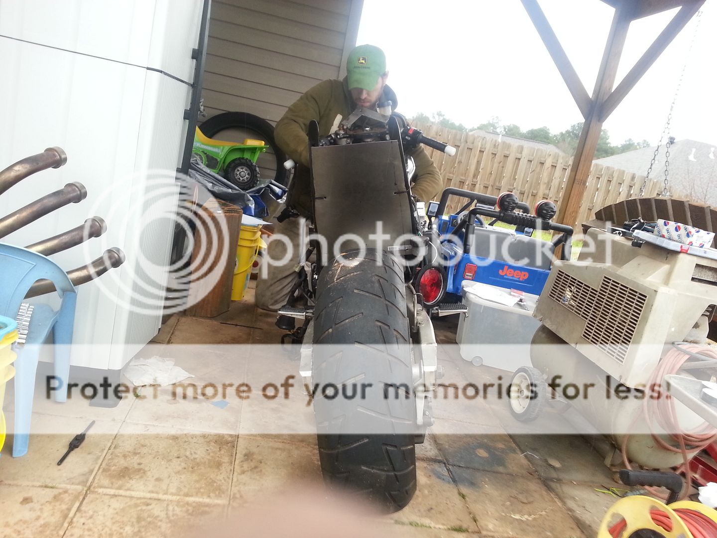

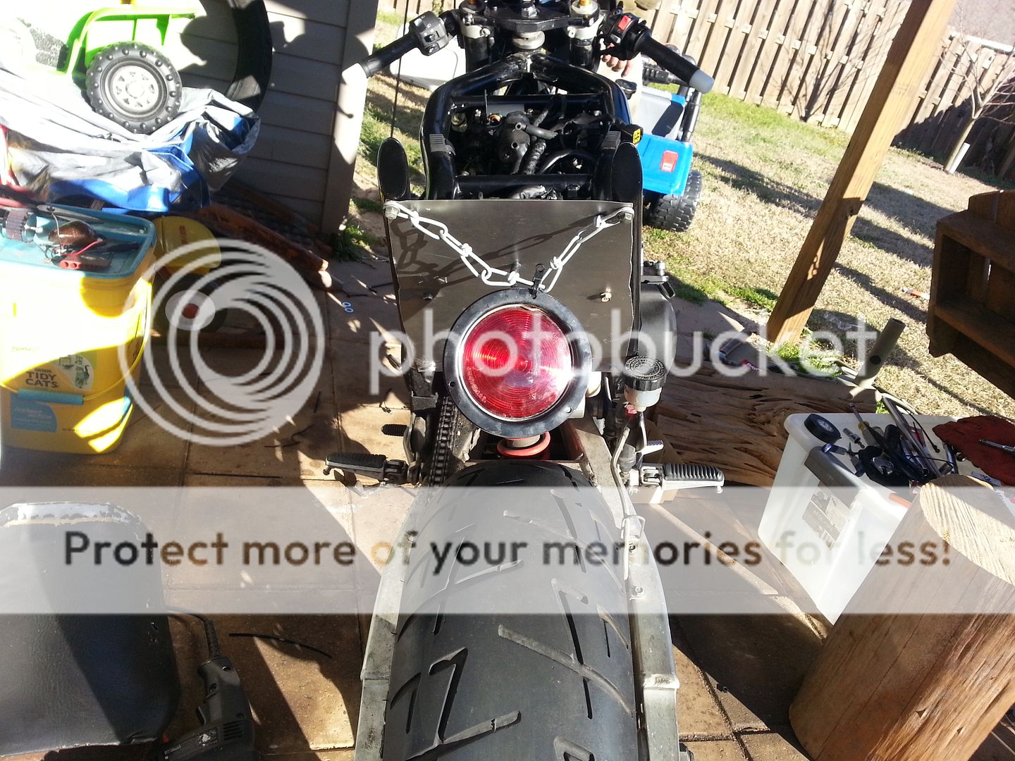

Made rear fender
Made Headlight brackets
Flushed Oil, Coolant, and tank.
Fixed my head stud
Fixed the thermostat housing
Fixed clutch cable
Fixed throttle cable
ETC
ETC
ETC

I drove it 30 miles today to work and when I got there somebody said " You forgot to polish your other shoe" I replied "Huh?" I looked down and said FML
Oil leak on the right cover. Nothing major.

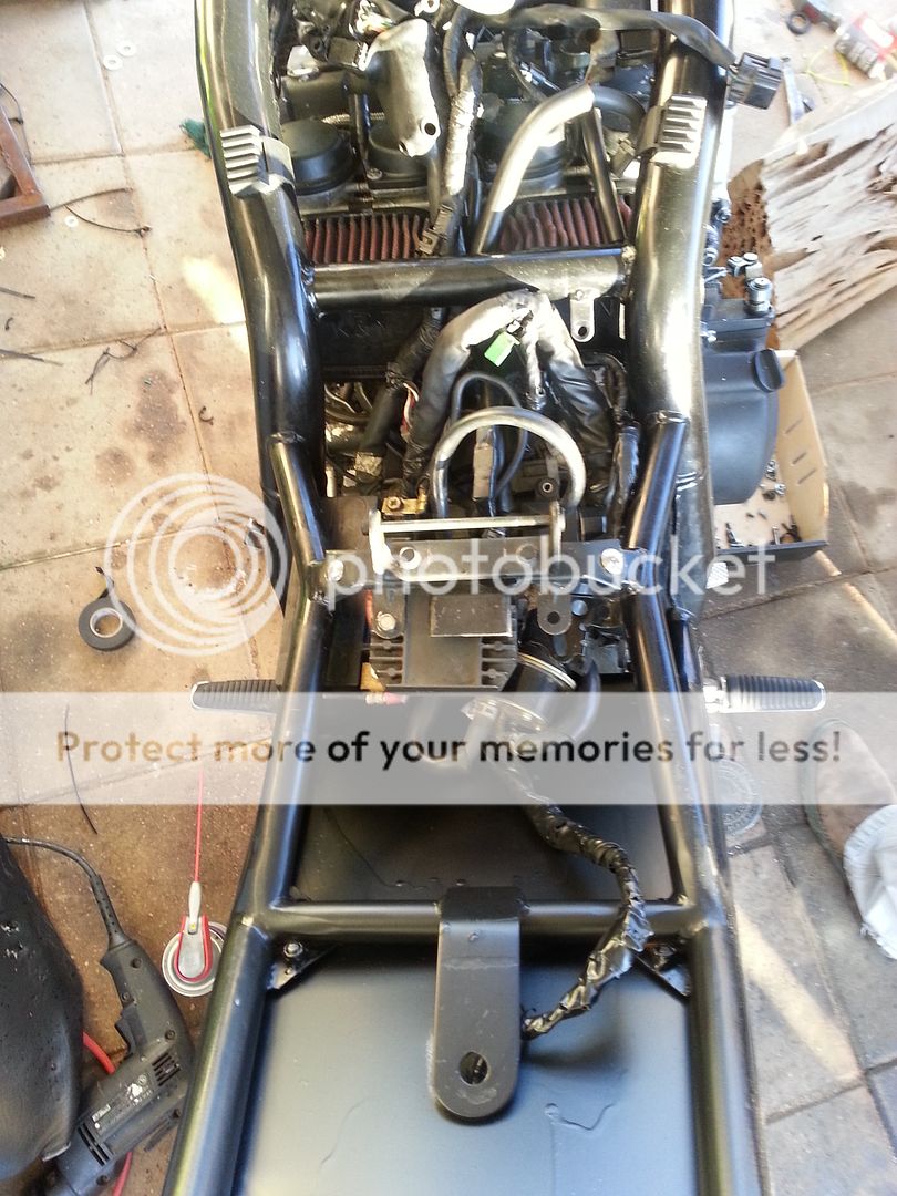

I have alot left to do. I have to make some side fenders still and tuck some wiring. I need to make a choke bracket and finish the exhaust. I am welding up a exup plate to seal up the header tonight and addressing the oil leak.
I am going to order some good vinyl for the seat eventually. I gotta order some new plug boots too among 900 other things

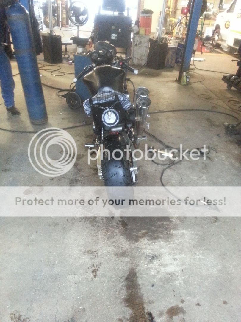

It defenatly shows creativity with a gruff and edgy look like its ready to go to war.!!!!!
The things I really like with the gen 1's are they are easy to work on yet they maintain some traditional looks. The frames double cradle down tubes wrap around the engine with just on the right amount of incline forward looking racy....Oh ya parts are cheap
and Black is beautiful!!!!

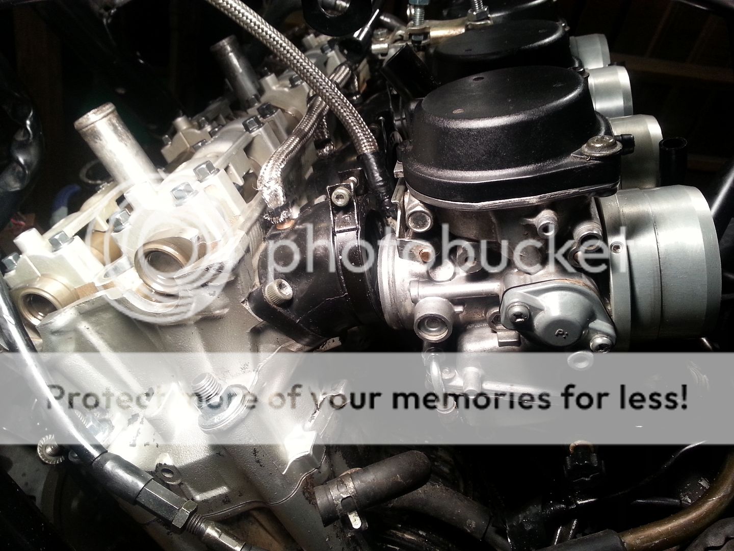

Well, I looked back at all the posts and I couldn't find one thing about the carbs. Were they cleaned or jetted when they were off the bike? Only asking because of your issue. Being that you have a timing advancer, pod filters and exhaust mods done, I'm thinking that it may be running lean. With your mods I would definitely go up some on your mains and also maybe an adjustment on your needles. Just a thought. Can you pull your plugs and see how they read?
Diaphragms and carbs were cleaned best I could but I didn't remove the bowls.
I never put the advancer on . It is only "lean" on partial throttle...
Carbs were jetted by PO. They looked like they were in great shape when I had them out and cleaned them. Never checked the bowls though
I am thinking spark related so I got new coils and boots.
It doesn't smell on idle or load and my plugs looked perfect oddly...
Well we made a carb sync tool and synchronized them and it helped. We finally broke down and pulled them and found the float level off. I ordered a couple oem float sets to do it right.

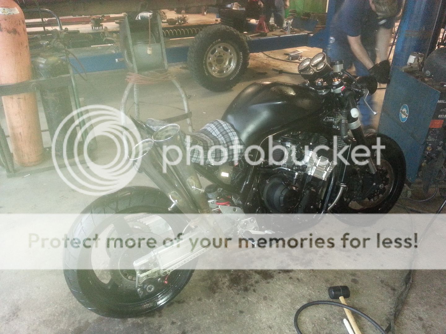

few changes to the bike
