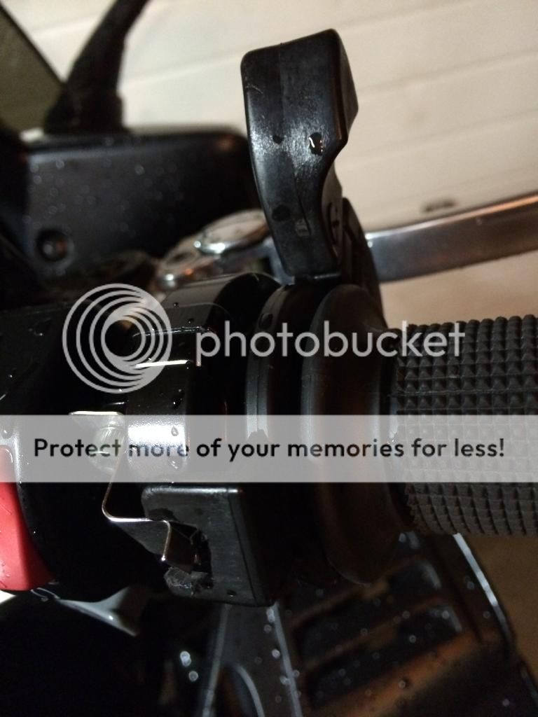

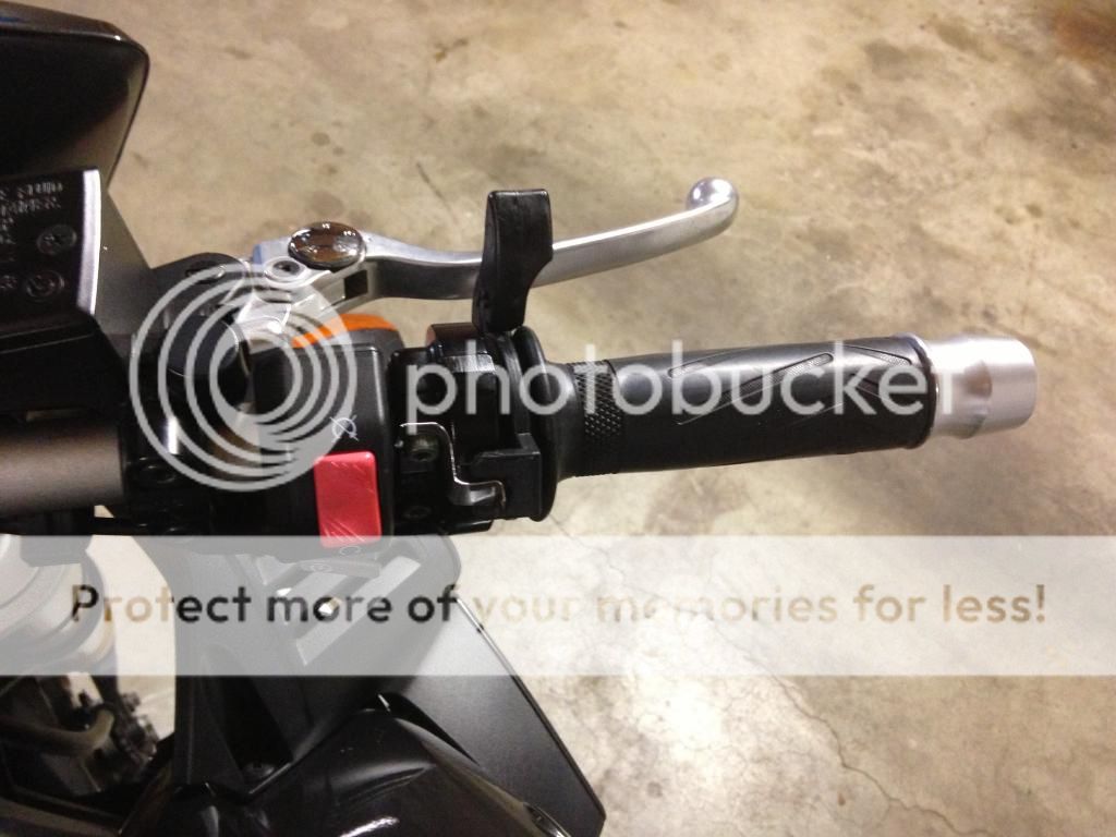

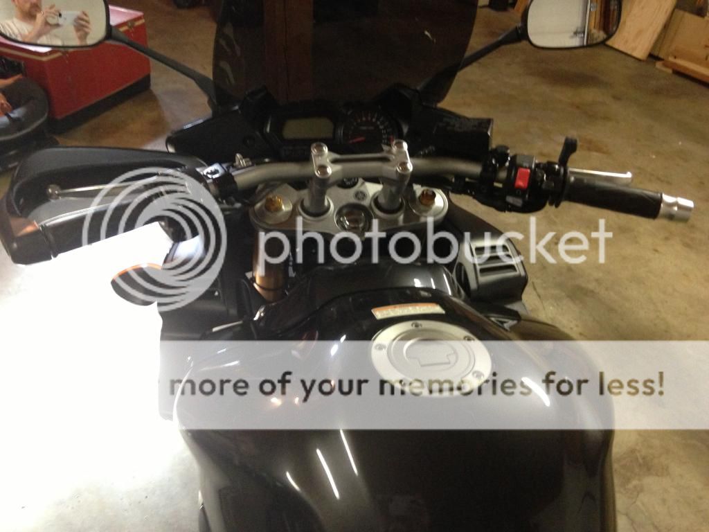

ok sorry I didn't get back on here last night, but here is how I set up my Vista Cruise. I didn't want the bracket and arms going across everything, I was looking for simplistic.
As you can see, it doesn't take up much throttle space, I didn't notice the change at all

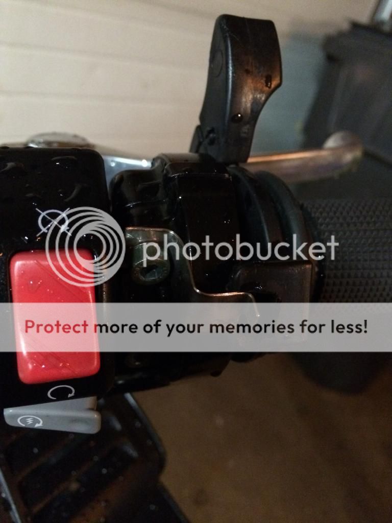

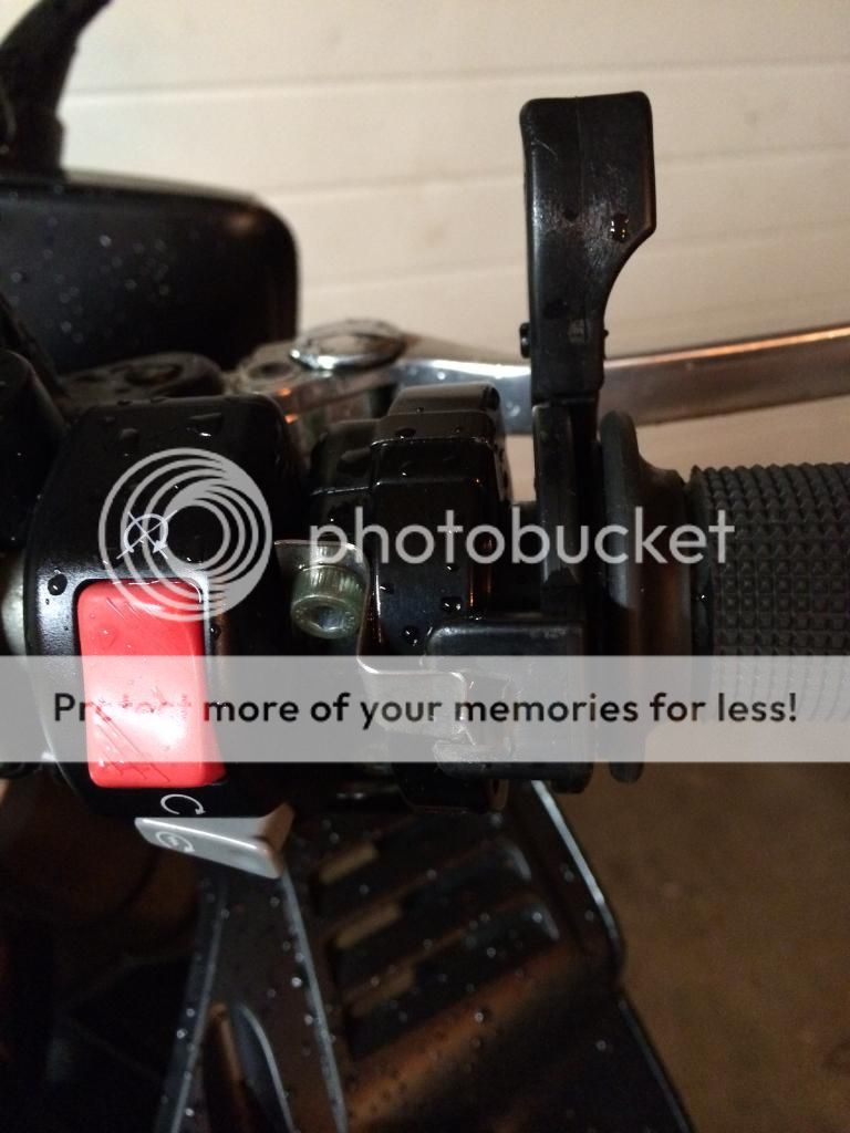

I just took a small price of aluminum and bent it to match how the throttle was shaped and into the notch for the lock
I love it and I don't think I would use any other kind. Reason is because its clean and simple, and extremely easy to operate. I use it all the time, even on my short 2 mile commute to work. Im just lazy I guess :D
