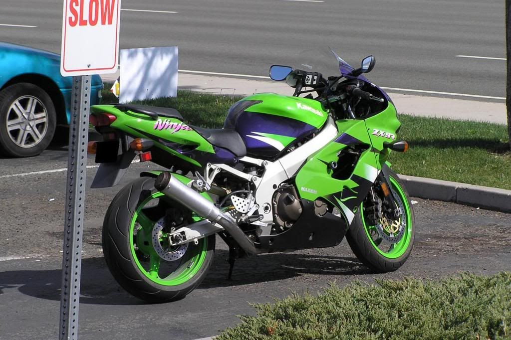

Dunno for the FZ1. On the 00-03 ZX-9R our mid-pipe outlet diameter is 60mm or 2 3/8," whereas SuperTrapp models come in 2 1/2 or 2.0" ID.what's the outer diameter of the headers where it connects to the slipon? I'm thinking about getting a pipe and welding the supertrap on it, instead of cutting off the slipon.

Any short-term update? Pros v. cons? Pics/videos? I think it does look clean. Almost wickedly trick. Don't know how I'd manage with the heat to my boot though.Oh well, at least it looks clean as hell.
I'll try to get some video/pics this weekend.Any short-term update? Pros v. cons? Pics/videos? I think it does look clean. Almost wickedly trick. Don't know how I'd manage with the heat to my boot though.
I still love the way it looks. I love all the sounds it makes.
I ride to work 4 days out of the week usually. I have not had any hot boot problems.
The performance loss is kind of bugging me though...
I can't speak for the unit you have on there, except to say that if it is restricting flow at six diffusers and muffler cubic volume isn't an issue, then adding diffusers is your best option. The 4" six-pack w/screws should be under $20....The performance loss is kind of bugging me though...
