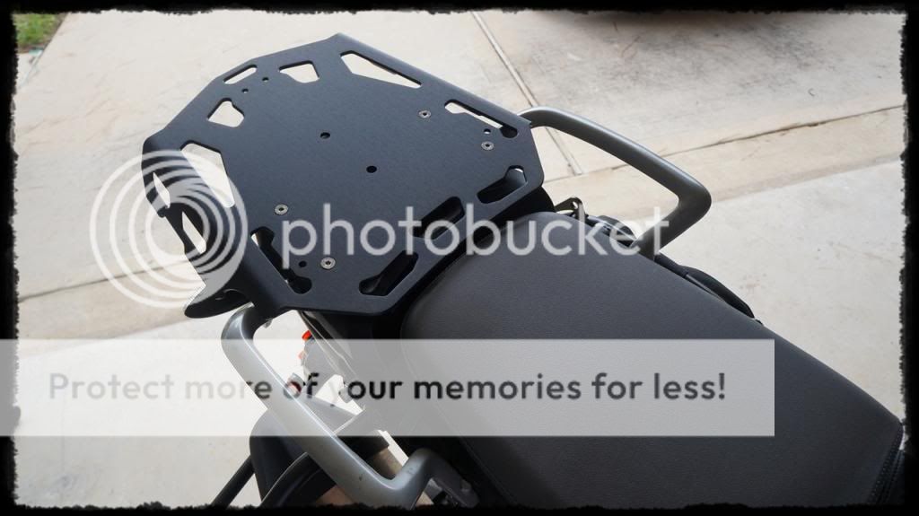

The stock cargo rack is small and made of flimsy plastic. It cannot be used to fasten anything down to it.
The new AltRider luggage rack is much larger and sturdy enough to use for mount/fastening points. Beautifully crafted as well.
The new AltRider Luggage Rack installed.

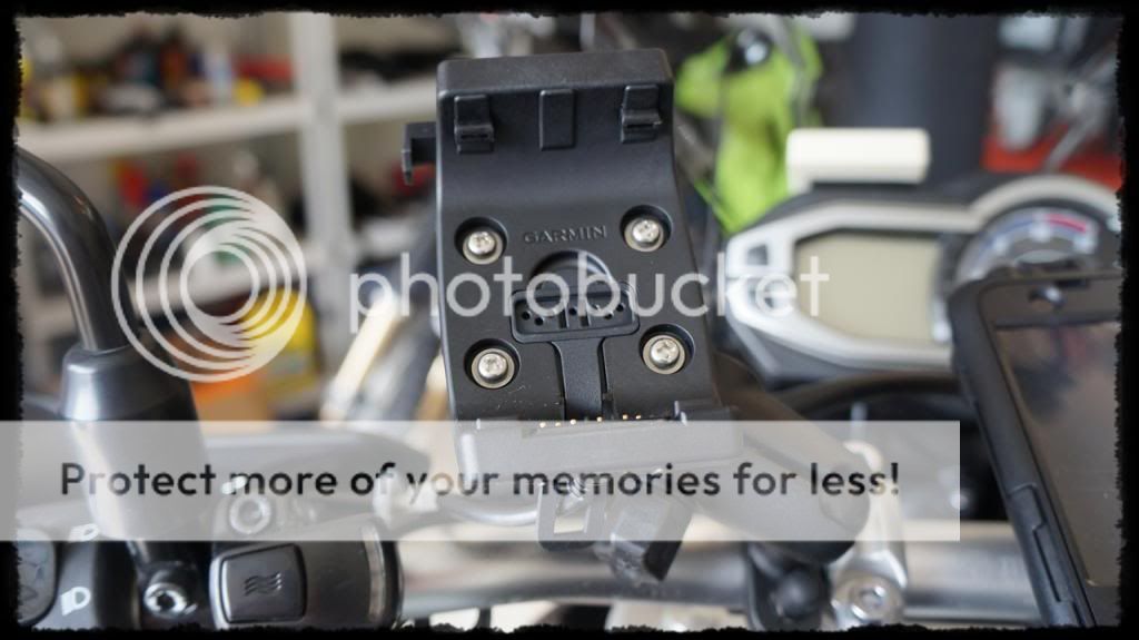

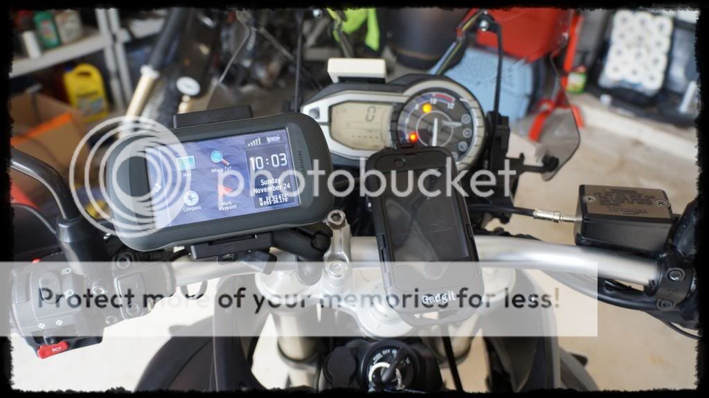

Got my powered Garmin GPS mount installed in to the new FuzeBlock on slot 1.
Garmin Montana 650t
HeatDemon heated grips. After trying these yesterday I am convinced that the heated grips on my VFR actually never worked. I also like the visual cue on the thumb controller that it is working. It has 5 settings. Off and 4 temp settings. It is awesome!

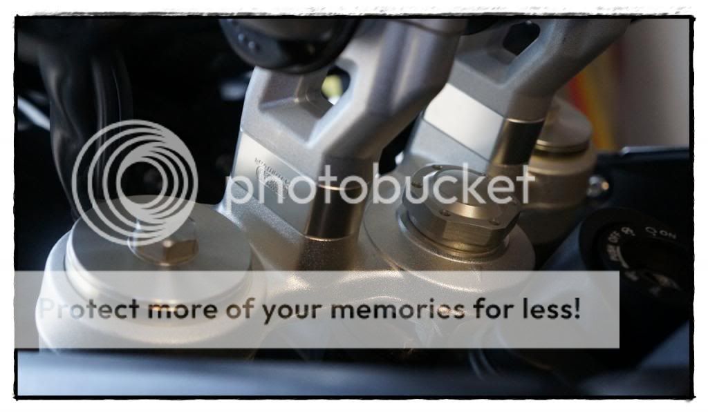

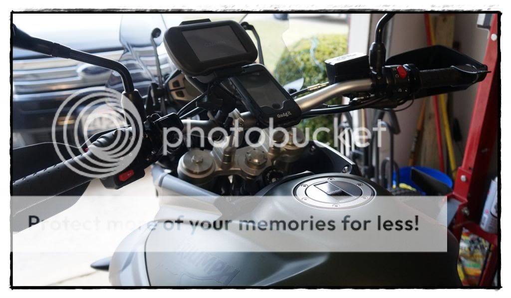

My wife got me some SW Motech 20mm risers for the Tiger 800XC. I never thought 20mm would make much of a difference. ....they do!
I will probably make some bar rotation adjustments on this weekends pie run.
