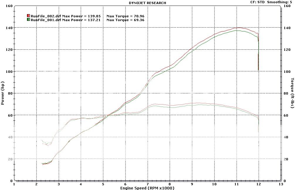

Well guys I had the dyno tune done today and here are the results. The Green line is the ECU Unleashed with PCV 'Zeroed' and the red line is the ECU Unleashed with the PCV tuned. As you can see the PCV smoothed out the AFR which resulted in 2-3 extra horsepower. Is it really worth having both ECU Unleashed and a PCV? well that would make for some interesting discussion I guess. Personally, I would have been happy to have just the ECU Unleashed, but I had the PCV already on the bike so thought I may as well make use of it.
Here are the imperial results below 139.85 Horse Power:

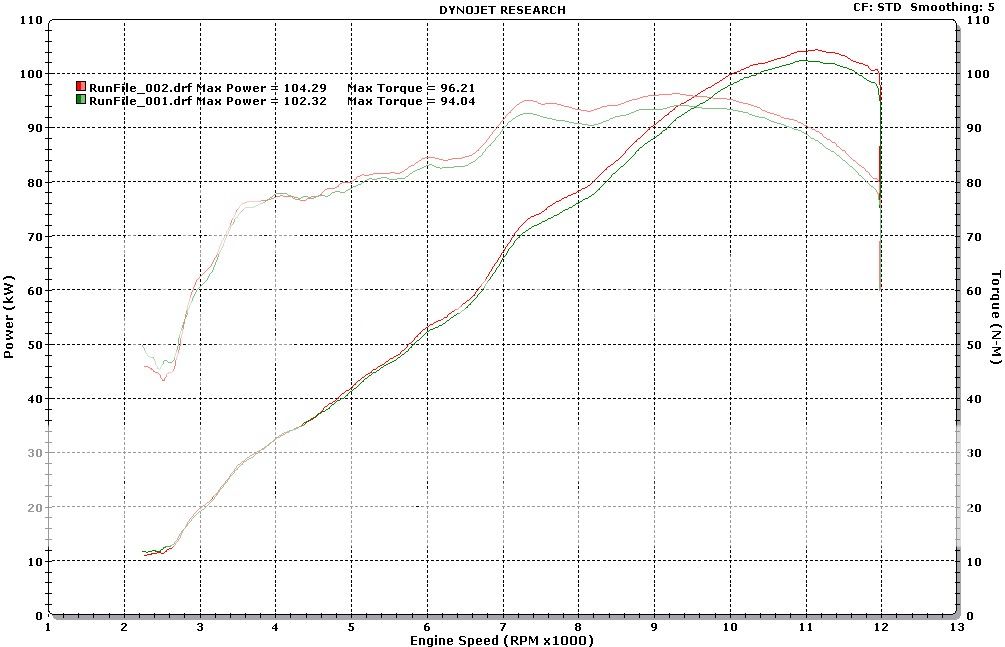

Here are the metric results below:

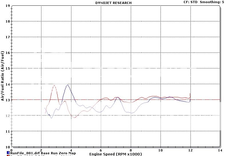

Here is the comparision in AFR Below - Red is PCV, Green is ECU Unleashed and PCV Zeroed:

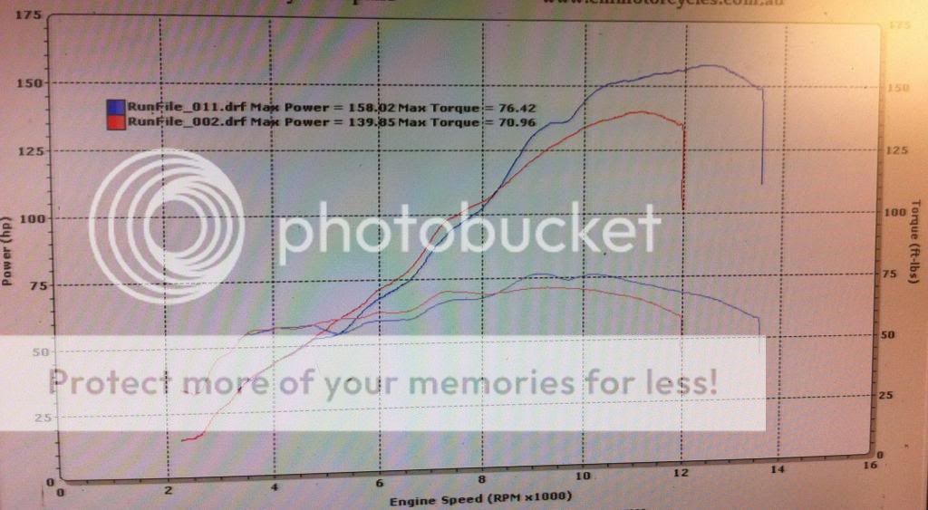

Here is a comparision on my 2011 FZ1 Power and Torque Curves (Red Graph) and a 2010 YZF R1 Crossplane Crank (Blue Graph) below - Notice my FZ1 made more power and torque up to 8000rpm, i was happy about that :)
