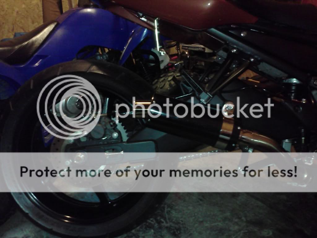

Yes its a gen2. i just have bolt on extension on it from yana shika. I think my wheel base is around 64&3/4 inches. only catch is the
nub for the break on the arm has to be ground smooth for the tire to fit so it can not go back to stock. most of the parts are for a r1
Ahhhhaahhaahaha thats fookin awesome so wanted to do that to mine for so long but need the cash and dont know of any good tuners in perth closest one 2-3 hours away. would be fun freakin out the rice burners
take it easy on that lil meanie!
I sold my GXSX1400 turbo, to a guy in perth a couple of years back. You may see it around :)
Nice to see a close up at your bike!

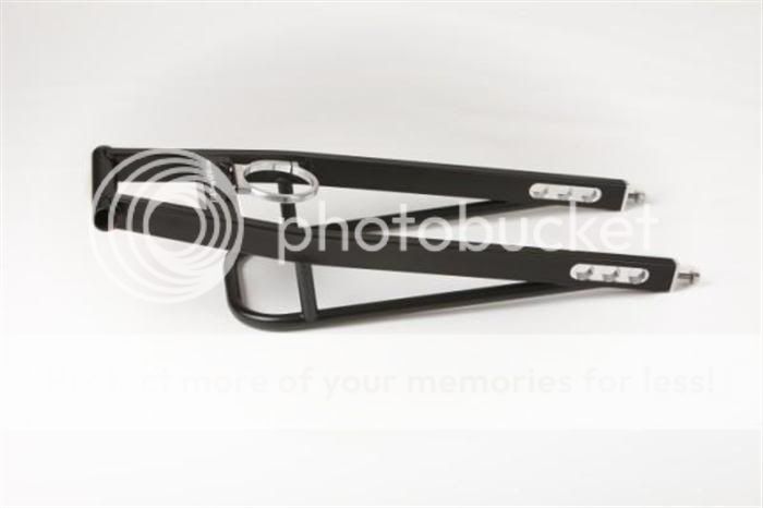

But i think it looks to weak for me. But im glad to see that there is a solution. I would rather have a new swingarm.
Alot of people dont trust the bolt on extensions. I have seen some 8 second passes with them on a zx14. My buddy has a swingarm on his busa from Evil Swingarms, I am not sure if they make one for the fz1 but with your skills i would bet you could just copy on theirs. probley wouldnt be to bad to jig the bike and tire then connect them. they just use square tubbing and under brace it with round tube. He bought one with out under brace first and it was good till about 215hp. it started to flex when the power was bumped up to 410 and ate a couple chains befor he figured out what was wrong. Sent it back to have it braced but only made a few runs since so not sure if its going to be enought. may have to brace the top. its hard to describe the pull a high hp bike is when it hooks and dont come up with the front. I think it went 179 mph in the quater mile so far.
