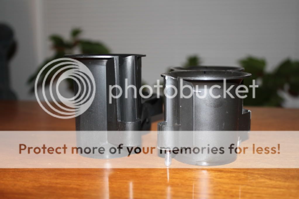

I already posted these pics on another thread but I thought I would post here also for future users. There was a question about how the stock velocity stacks compare to the Graves:
Stock ones are on the right

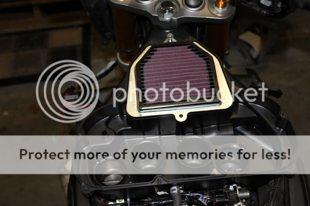

Installed on the bike:
In addition I will say that the combination of the stacks and/or the airbox mod makes a wonderful noise coming from under the tank!!! I love the way that sounds which almost makes it worth the $150 for the stacks!!
