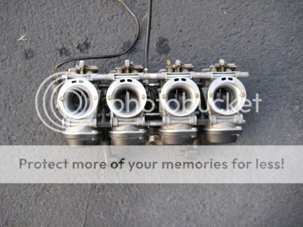

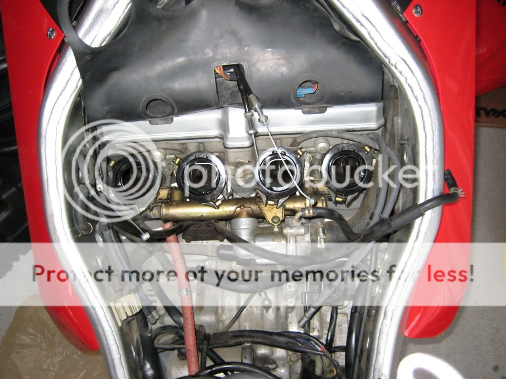

Well the carbs are off!!! What a PITA :banghead: I haven't taken them apart yet so don't know how bad they are, but I'm sure new jets and plenty of carb cleaner will fix them ;)
Off the bike:
Needs a good cleaning:

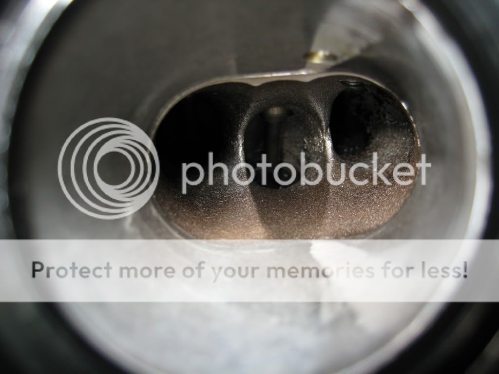

Nice intake port and valves :D

Well got out of work a little early today and decided to clean the carbs and install the jet kit. They were relatively clean inside and everything went smoothly except for the part where I lost one of the tiny washers that go with the idle mixture screws. Luckily I eventually found it...phew. Plan is to take next Wednesday off and put them back on and sync the carbs, then go for a ride. Maybe I'll head up to Bear Mt for bike night if the weather is good :D
All nice and clean...
They were quite dirty. Good work cleaning them up! Jets, sync and set the idle and it should be a smooth running bike! There isn't a lot more you can do with this without a complete tear-down now!

Well the carbs are back on! Now I just need to tighten everything back up and sync the carbs. Hopefully it's back on the road this coming Wednesday ;)
